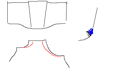

PostPosted: Tue Sep 19, 2006 12:53 pm
Steve, a drawing or picture would really help here. I know I for one am having trouble visualising what you are talking about.

Thanks Joe
I'll post a pic to clarify this evening - only have MS Paint and a scratchy mouse here.

PostPosted: Wed Sep 20, 2006 8:18 pm
Joined: Tue Feb 21, 2006 1:03 am
Posts: 22
Ah, so rebate to suit the purfling first (true to the back), perhaps installing sacrificial 'binding' too, then redo the rebate (true to the rib) to suit the binding.
Really bad pics attached - I got waylaid last night, so ended up using paint anyway.
I've tried to show end on, the diference between top and back outlines and the binding channel.
